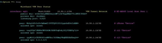

There is nothing in the debug that suggests that the request to set the Auto flag failed..unless the import of 'ubimo' went into the wrong table.
Post the output of these two commands
e  = Exit Script [?]
E:Option ==> diag sql clients
e  = Exit Script [?]
E:Option ==> diag sql devices
I have just tried the import with your test 'ubimo.conf' (I suggest you immediately delete access and remove the config from this thread - unless it is deliberately fake;) )
E:Option ==> import ubimo name=
    [✔] Peer ubimo import as wg15 success
    Peers (Auto=P - Policy, Auto=X - External i.e. Cell/Mobile)
wg15    Y     172.16.0.2/32    engage.cloudflareclient.com:2408  1.1.1.1         # Cloudflare Warp
e  = Exit Script [?]
E:Option ==> start wg15
    Requesting WireGuard VPN Peer start (wg15)
    wireguard-client5: Initialising Wireguard VPN 'client' Peer (wg15) to engage.cloudflareclient.com:2408 (# Cloudflare Warp)
    wireguard-client5: Initialisation complete.
     WireGuard ACTIVE Peer Status: Clients 1, Servers 2

This is the output of diag sql clients
WireGuard VPN Peer Status
Kernel IP routing table
Destination Gateway Genmask Flags MSS Window irtt Iface
10.50.1.0 0.0.0.0 255.255.255.0 U 0 0 0 wg21
DEBUG: SQL '/opt/etc/wireguard.d/WireGuard.db'
Table:clients
WireGuard ACTIVE Peer Status: Clients 0, Servers 1
This is the output of diag sql devices
Table:devices
Device Auto IPADDR DNS Allowed Public Private tag Conntrack
ubimo X 172.16.0.2/32 1.1.1.1 0.0.0.0/0 bmXOC+F1FxEMF9dyiK2H5/1SUtzH0JuVo51h2wPfgyo= (new private key, hidden by me) # Cloudflare Warp
