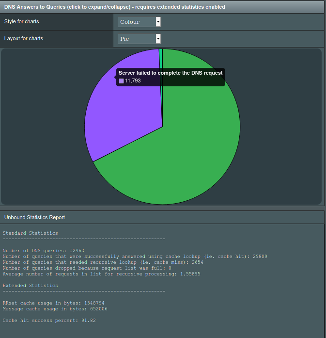

I installed unbound manager through amtm. Everything is working and snappy. One question I have though is after installing the unbound stats GUI, the pie chart shows a slice with 'Server failed to complete the DNS request.' Just wondering if that is normal. The unbound statistics report below the pie chart seems ok.
The Pie chart is representing the unbound statistics variable num.answer.rcode.SERVFAIL
Even with only a small number of DNS queries (3798), my system shows 58 resulted in SERVFAIL. - 1.5% failure

If you enable unbound logging you can see which requests result in SERVFAIL
e.g. see the following post for methods to investigate
