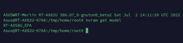

So regarding the router model - I'm pulling this directly from NVRAM... so if you open up an SSH session and type:
nvram get model
What do you see? I found this site that mentions that the RT-AX58U_EPA is a Chinese router only? http://en.techinfodepot.shoutwiki.com/wiki/ASUS_RT-AX58U

Id does say RT-AX58U_EPA when i pull the router model directly from NVRAM.
I bought the router from a Chinese Online site, but it is the RT-AX82U model...
Well, as long as it continues to function on that AX82U level, I guess there's nothing to worry about, so you can ignore that info. Now at least you're aware incase any future issues arise. ;)
