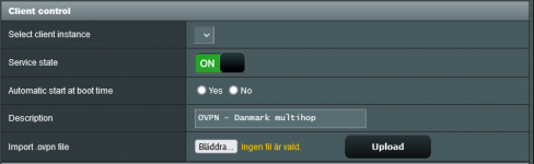

Thank you to new build, just loaded new Alpha2 (alpha2-g23082e2452)
Found some things:
On then vpn-client 1-5 drop down select:
Screenshot 2021-11-02 at 14-09-37 ASUS Wireless Router RT-AX86U - OpenVPN Client Settings.png
Uncaught ReferenceError: vpn_server_array is not defined
initial http://192.168.12.1/Advanced_OpenVPNClient_Content.asp:172
onload http://192.168.12.1/Advanced_OpenVPNClient_Content.asp:1
Advanced_OpenVPNClient_Content.asp:172:1
Same on this screen:
Network Settings, Redict Internet traffic through tunnel.
Screenshot 2021-11-02 at 14-10-26 ASUS Wireless Router RT-AX86U - OpenVPN Client Settings.png

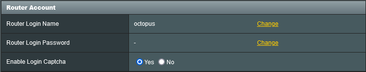

On router Account Page:
Screenshot 2021-11-02 at 14-11-56 ASUS Wireless Router RT-AX86U - System.png
When click on dropdown, Verify Server Certificate Name: Value disappear.
Screenshot 2021-11-02 at 14-51-17 ASUS Wireless Router RT-AX86U - OpenVPN Client Settings.png
