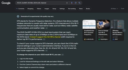

What would an AiMesh configuration look like?
I have a ZenWiFi AX Mini connected to the router via ethernet, that's it.
Seeing the additional channels was not an issue prior to the update.
Just did a quick search in Google. Looks like ZenWiFi AX Mini model doesn't support DFS channel (Refer to the screenshot below) and that is why you are not seeing the DFS channel in your main router.
Please confirm by removing this node from your Mesh network and see if that resolve your issue.
