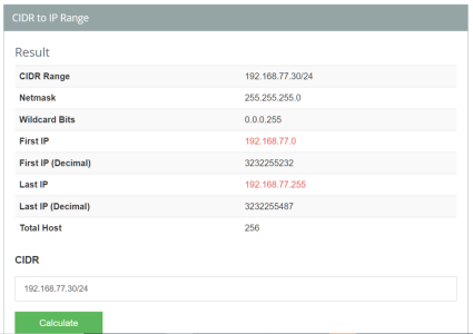

i like to report NAT Problem with VPN Director when i add rule to Nat Single IP 192.168.77.30/24 to vpn concoction the whole subnet 92.168.77.0/24 redirected to vpn connection
192.168.77.30/24 is the same as 192.168.77.0/24 - I will include all IPs in that subnet.
If you want the a single IP then you just use 192.168.77.30
You can use this tool to work out CIDR ranges.
