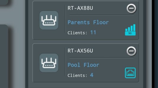

A bug Im not sure what's its origin/source, AiMesh units does not show Thumbnails in AiMesh on "Homepage"- AiMesh Nodes.
Anyone knows?
Reboot done actually few times already to the Nodes.
Does not intent to factory reset it now, takes too much time I don't have 😂
started on 388.6_2,.on 388.6 it was OK.

DId a reset to mesh units and router.
Well, didnt help.
Icons do not work
Cache is wiped reseset and all of it.
Bug that did not happen in 388.6
@RMerlin , not sure if it is related, but I did everything from my side, and cannot fix it.

@Damit1 I have no icons problems with my customers on the latest version 3004.388.6_2 :
Thank you for this information @bennor and @RMerlin ; if it's normal, it's all good.
So far, I'm happy with this new version. No problems to report :
Not with clients, on Clients it is OK.
with AiMesh nodes, not clients
