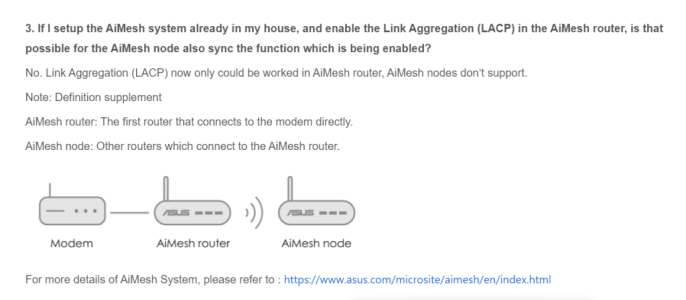

Asuswrt-Merlin 3004.388.6_2 Firmware installed successfully in my two RT-AX88U.
Works well!
NOTE: According to the ASUS SUPPORT, Link Aggregation (LACP) now only could be worked in AiMesh router, AiMesh nodes don’t support.
So, wired backhaul is only possible using just an RJ45 cable.
My mistake! 🤣
THANKS!!!
