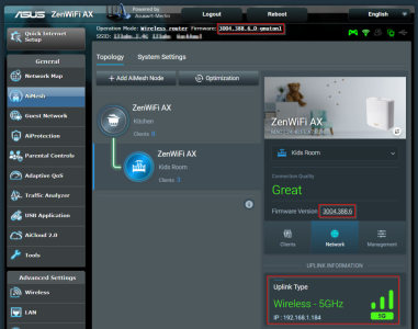

Just did a dirty upgrade on my set of 2 pcs Zenwifi XT8's from RT-AX95Q_3004_388.5_0-gnuton1_puresqubi.w to RT-AX95Q_3004_388.6_0-gnuton1_puresqubi.w without issues so far. Wifi uplink to second node hooks up fine.
