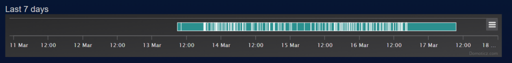

see the before after and before
before very stable wifi, no disconnects(blue)
after 866.2 may disconnects(white)
now again 866 rock solid for days(blue)

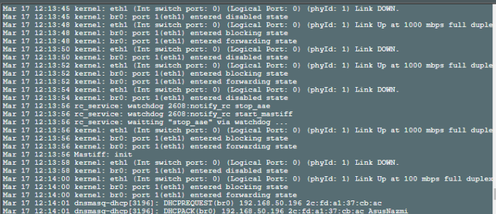

Hi, I upgraded GT AX6000 to the latest version. Every few hours the ethernet connection drops for a few seconds. I did a clean install to the latest version. Is there anyone experiencing this situation? Does anyone have a solution? Help please.. (I also tried different ethernet ports and got the same result. The cable model I use is Ugreen cat6a.)

From what version to what version did you update to?
When was the last time you performed a full reset to factory defaults?
Do you have any other brand Ethernet cable Cat5e to try?
I upgraded from the previous version to version 388.6_2. After performing the upgrade, I turned off the device for 10 - 15 seconds and after turning it on, I reset it to factory settings. I made this happen two days ago.
I also have a Tplink Archer C4000 router. When I connect this device, I can connect with the same cable (ugreen cat6a) without any disconnection.
It may not be the cable. It may be the connector (i.e. 'tolerances').
