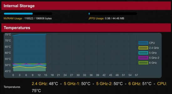

Hi guys, I am new to Merlin… I just installed it onto my GT AXE 16000 performing a complete reset and configured it new.
So far, everything looks to be working fine but I noticed that the CPU temp is consistently at 75C.. is this normal?
Thanks in advance for your help.

While you may not enjoy being that hot, your CPU is nice and cozy.

Mine is running at 34 C to 39 C. Same router but I have a fan under the router.

I have a fan on top of my RT-AX88U to pull air up and out. It helps a lot, enough to justify the cost (around $25). Just be sure to use an inductive ball bearing type for longevity and noise. If you use some non inductive (brushes) it could possibly generate enough electrical "noise" to affect the router. BTW, with the fan my CPU is running at 43c. Without the fan it ran at around 70c.
You're running the fan for no reason then (except to collect dust...). 70C is well within the specs for the SoC.
