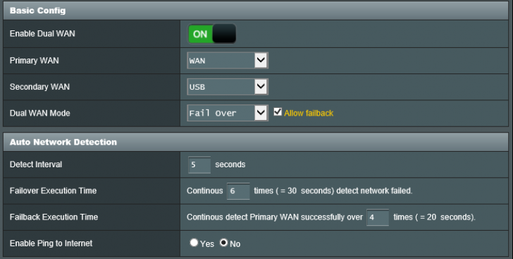

3G/4G not work corectly. I have failover settings with allow fail back, but when primary wan is back then router not switch to primary wan....only router reboot. On 9460 work ok.
for more info
I have pppoe wan and echo detect on.
My friend report that work ok on his 88u with dhcp wan
