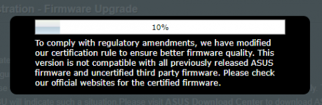

I have a RT-AC68U that is constantly connected to VPN server. It was made to allow remote connection to the router and home network because router has no white IP. The router runs 386.1.2.
With release of 386.2 I have tried to update the firmware remoteley. The following screen appears:
However the process continues and at the end the message was shown saying "update is successful, please reboot your router manually" (or something like that - standard message).
I've tried to reboot and to update the firmware several times - no success: it reboots but the firmware was still old.
Today I am at home and I updated the firmware without any problems mentioned above. By the way the reboot was automatic.
Any ideas why remote update scenario was not successful?
