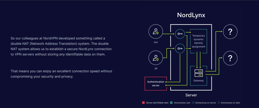

If they don't make it easily downloadable from their webui, there must be a reason. I suspect it's tied to how WireGuard relies on private keys to handle all authentication instead of a username/password. Maybe they don't have a centralized method of generating/storing these private keys.
As per the admission by Jason A. Donenfeld that there are known limitations of his Wireguard protocol....in particular the obfuscation/tracking concerns
hence NordLynx provides their additional front end obfuscation layer
Is there a way to get the Nord Lynnx to run on the router end? There are no config files for this as I have Nord VPN and was looking to impliment this on the router end. For the heck of it I tried it on my windows 11 laptop and it is just as fast as Wireguard.
People really should just stick to OpenVPN when using a VPN tunnel with the goal to obfuscate their online activity. WireGuard is a great idea when the goal is to remotely connect two sites that you control. Having it implemented at the kernel level as just a dedicated network interface makes things nice. Not so good for what most people here want to use their VPN for.
