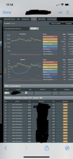

Quick question. I am new to this I have been trying to research this so I didn’t need to bother anyone but everything I try does not seem to work.(new iptable rules etc.) I know enough on how to install Flex but flex doesn’t seem to be tracking my devices correctly. I am sure it’s me but as you can see flex is tracking the Roku correctly but the graph is not showing it under video streaming. It’s seems to be putting everything under gaming. Further all my roku device under the graph are under gaming not streaming but they are tracked correctly. I have the latest Merlin installed and have an ASUS AX 86u. Thanks for your help.

Some rules look weird (Game Downloads going to work-from-home, cams going to Gaming). That Web Surfing rule is very unusual since it’s filtering on local port, which is unlikely to occur. Comparing your earlier debug output, you might have put the ports in the wrong field the second time. But I still believe that is a bad rule anyway. I’d delete it. Too much traffic is on port 443 these days.
Sorry the process isn’t easier, but you might consider starting over again.
