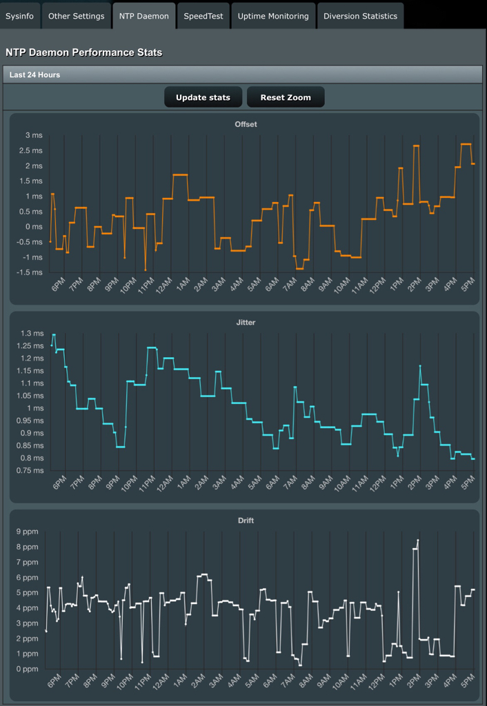

Graphs have pan and zoom - I'm currently puzzling how to do the weekly ones - plotting 5 min intervals for a week is too much data
It works perfectly for me, I had to force the update to get it to work properly thank you for the new update it looks way more modern.

Checked this morning, showed a single pane, no data.
Did the “u” update. Working like a charm now!
It’s been running fine for 24 hours [emoji4]
