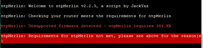

So trying to uninstall NTP merlin to do a reinstall of it i'm getting this on reinstall. I didn't clear the previous config files.
Looks like I will be forced to reboot.
a reboot didn't solve the issue.

The weird thing is that despite I removed ntpMerlin, rebooted the router (which got rid of the duplicated tabs from the gui) and also received that message about unsupported fw version (when I tried to reinstall it), I still had ntpMerlin installed in amtm, and I was able to uninstall it again (perhaps I had two installed?)
i'm able to install it back now but its missing from Webgui and same with Uidivstats also.
Both reinstalled but won't show up in Webgui
Do you have the new Addons bottom under Network tools on the left hand menu?
Yes
Ahh I see it there now.
Is this going to be the new location for the add ons instead of tools?
