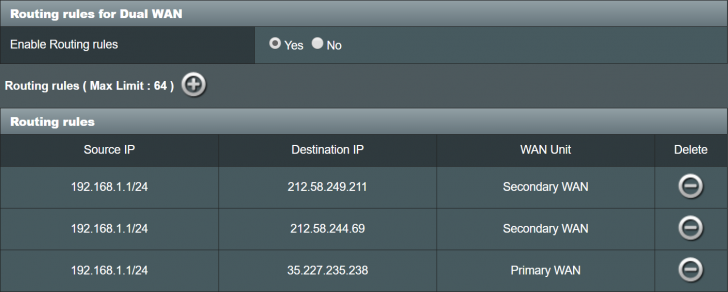

You can check the status of the existing Dual-WAN RPDB rules inserted when using the GUI.
ip rule
..then simply match the rule syntax for the websites.
NOTE: URLs/Domains cannot be used directly, so if there are multiple IPs for each website it will require a rule for each IP to ensure that ALL website traffic is routed appropriately.

No, not for Selective Port Routing.
However if you just simply want to ensure that all LAN device access to a particular website is via a preferred WAN, then yes the GUI may work.
e.g. Route access to the BBC UK website (2 addresses) via the Secondary WAN, and the CBS US website (1 address) via the Primary WAN

However, if there any target address changes you will need to amend the entries, and unless you can correctly identify/define all of the website in CIDR format, the GUI limit of 64 entries may quickly be reached.
