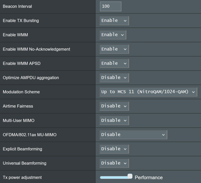

All going well with 3004.388.7 to 50 odd home clients on the GT-AXE16000. Only quirk is the homes two LG appliances, Stove & Fridge, will drop from the 2.4GHz connection (only supported on 2.4Ghz) after 3-4 days. I believe this started since 388.7 alpha levels & onward to today's 388.7. Same symptom occurs with the LG appliances to my GT-BE98 Pro and its 2.4GHz setup.
My 2.4GHz setup is basic for clients that only support 2.4GHz. The 2.4GHz setup, if anyone had any ideas.
Reference: Wireless levels on the GT-AXE16000 for 388.7
Look at the 2.4GHz setup posted by @Tech9.
Starting from what I had enabled/disabled on 2.4GHz settings & @Tech9 document's for 2.4GHz, created a setup of tech9's doc. On this setup my seven Roost heat/humidity devices quickly dropped from the 2.4GHz, but the two LG appliances which started this quest, now stayed online. Went into debug mode, changed three setting's at a time from the Tech9 doc to what I previously had enabled/disabled. Found all would work "in my environment", by changing only "Preamble Type from Short to Long" on my setup. e.g. LG appliances & Roost units now both stay online...yippeee.
