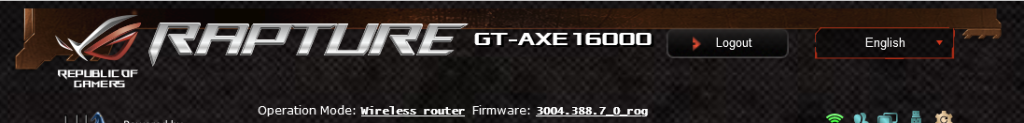

Sadly for me this update doesn't want to play nicely with my router, namely GT-AXE16000
Upgrade from 388.6_2 rog to 388.7.0 rog
All I'm greeted with is "Please Wait, Applying Settings"
I left this run for a good 30-45min, having never come across such a strange issue when updating. All the internet around the home is working fine, without any issues.

EDIT: Would like to quickly add that I have attempted updating with the non ROG version, but the same issue occurs.
upgraded normally from previous release (388.6_2) on my end

Do a forum search, others have experiencing issues of the firmware not taking and or just hanging during the firmware flash. If you haven't tried the usual troubleshooting steps, probably a good idea to try them:
Clear the web browser's cache.
Try a different web browser.
Try a different computer.
Do not flash from a mobile device, use a computer.
Disable any browser add-ons.
Do not try to flash firmware over WiFi.
Do not try to use the Asus app, always flash from a PC directly connected (using Ethernet) to the router.
Disconnect all other devices except one wired PC connected to the router prior to flashing.
Disconnect any attached USB hard drive connected to the router prior to flashing.
Temporarily disable any PC security software just in case it is interfering with the firmware flash.
Temporarily disconnect the WAN connection on the router prior to flashing.
If using any add-on scripts, see if they can be temporarily disabled prior to flashing.
If any VPN is running on the router, disable it before attempting to flash the firmware.
Check the router system log for any errors or issues.
