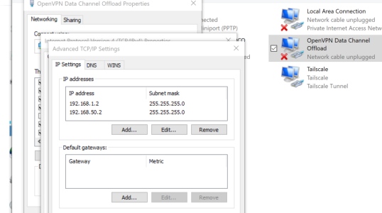

also while you are seeing it boot up when it first answers at either 192.168.50.1 or 192.168.1.1 (i would wire directly into the router from a pc turn off any other wifi or other ethernet connections and
hard code both ip addresses (192.168.50.2 and 102.168.1.2) in windows (assuming windows) to the router.. then open in command prompts in windows ping -t 192.168.50.1 and also in another window ping -t 192.168.1.1,
see attached pic for an idea what it should look like
type in this in windows in a command prompt
tftp -i PUT firmwareafile 192.168.1.1 ( or 192.168.50.1 or which ever ip answers for a very short time during boot. i believe it is 192.168.1.1) have it ready to go and only hit return when you it first answer to one of the ip addresses after a power on.
change firmware file with the firmware you want to flash.. also as mentioned then wait a good 15 minutes without touching to see if it reboots. it usually takes two boot cycles.
to install tftp in windows you may have to add it under add programs/add windows features i dont remember exactly
