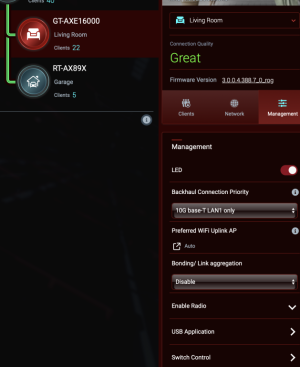

You can only do two things with the AIMesh node,
1. USB Applications
2. Switch control
As in the attached snapshot.
Under AIMesh select the AIMesh node then click on the management
Then you can click on USB applications or the Switch control to login and change settings.
