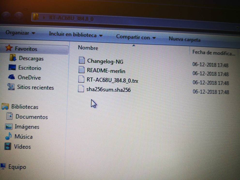

bues afternoon, I'm from Chile, I have the AC68U asus, I have updated up to 384.5, at the moment of updating with the next firmware, it remains as factory and it deletes all the configuration, it is done by resetting the equipment again and it does not stop doing anything, just I can do it until 384.5, I would appreciate your help from now thanks, greetings from Chile
Try to update to 384.8 and report again.

Attached current firmware image and the one I am installing, but remains as is and if I restart the router returns to factory values
Enviado desde mi BLA-L09 mediante Tapatalk
Try to remove any usb device and reboot and try to install again. Check sha256 on downloaded file.
IF that not working try to reset to factory default and try to install again.
It is flashed to occupy it with merlin, I have been installing firmware for more than a year and no problem, only now I can not update, I have tried with factory values and nothing
Did you read the link?
It doesn't matter whether you converted it, hacked it, repainted it, or whatever. Stop asking on the forums for help flashing your RT-AC68U when you actually have a TM-AC1900 - it's NOT supported, period.
