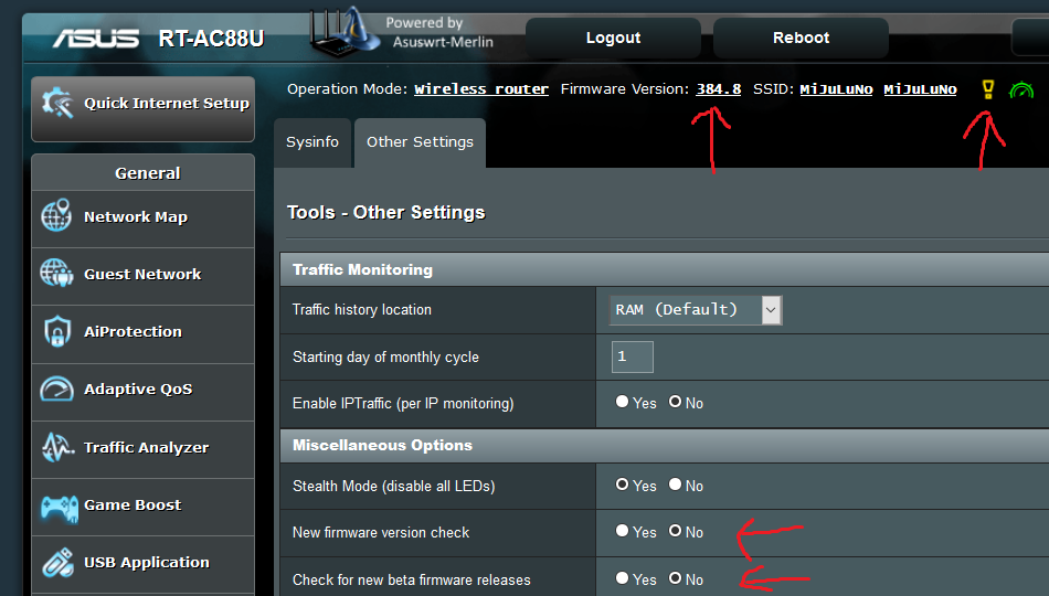

Does anyone else have the suggestion of removing the flashing, annoying yellow exclamation mark?
:confused:
With me, even after 24 hours nothing has changed.
:confused:
Try updating to the 384.8_1, maybe that might help.
Always worked fine.
:confused:
Did you check and disable
Tools | Other Settings | New firmware version check ?
Also for beta checks
:confused:
Click on the Check button on the Firmware Upgrade page.
Also make sure you really are running 384.8.
:confused:
After updating it was also flashing still flashing on my router, however it was gone after I turned the router off, unplug the power, turn the power button on for 10 sec. Then turn it off again, plug the power in again, and then turn it on. Forgot what the name of this method is:), maybe that helps for you also...

Something seems to be preventing your router from reaching the update server, as there are no webs_upgrade log. You can manually set the flag:
nvram set webs_state_error=0
nvram set webs_state_flag=0
nvram set webs_state_info=384_8_0
nvram set webs_state_info_beta=384_8_beta2
nvram set webs_state_update=1
nvram commit
