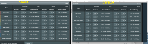

Quick question:
When I switch between stable and develop I noticed there is a change in the minimums for both download and upload for lots of groups.
Maximums are all 100%, only minimums have changed.
I am assuming this is intentional?

Quick question:

Quick question:
If you switch from develop to stable, the rates reset to defaults because the setting name is different and the name used in develop doesn’t exist in the stable code, and part of the conversion from stable to develop is to delete the old setting to conserve space in the settings file.
If you’re switching from stable to develop after February 4, this scrambling should not be happening.
EDIT: scrambling would happen since you may still have a bad flexqos_bwrates setting in custom_settings.txt from before the Feb 4 fix. So yes, set them properly again on develop and Apply, and it should be OK from now on.
