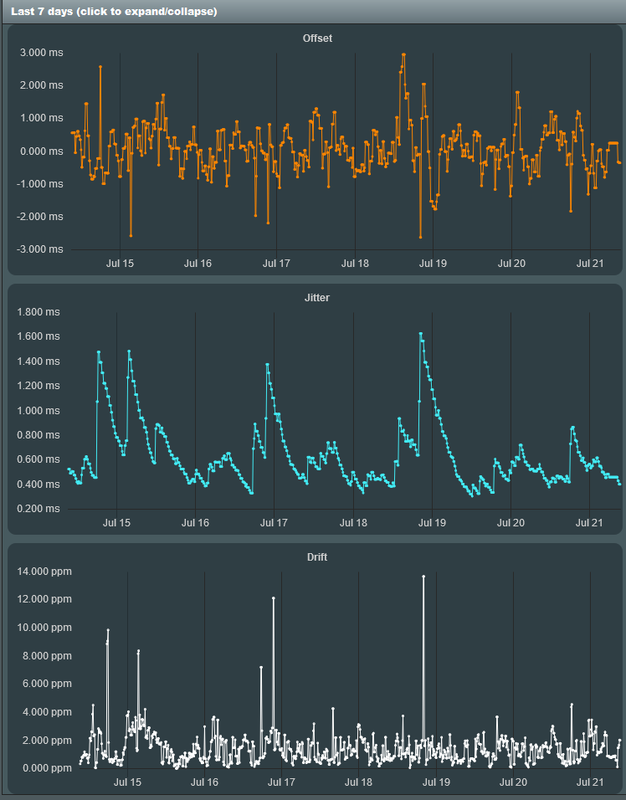

Well to for tracking accuracy of the ntp server, graphs can be helpful. For instance if i blindly use an ntp server and i set all my devices to get time from my local ntp server, it seems important to track whether the servers you are using are actually effective because you are telling your devices to trust the accuracy of your local ntp server.

interface ignore wildcard
interface listen br0
logfile /opt/var/spool/ntp/ntp.log
driftfile /opt/var/spool/ntp/ntp.drift
leapfile /opt/var/spool/ntp/leap-seconds.list # https://hpiers.obspm.fr/iers/bul/bulc/ntp/leap-seconds.list
restrict default limited kod nomodify notrap nopeer noquery # restrictive default IPv4
restrict -6 default limited kod nomodify notrap nopeer noquery # restrictive default IPv6
restrict source nomodify notrap noquery # required for pool directive if using restrictive default permissions
restrict 127.0.0.1 # permissive localhost IPv4
restrict -6 ::1 # permissive localhost IPv6
disable auth stats
notes:
i use pool -4 so that it only connects to cloudflare NTP on IPv4. I have disabled IPv6 on my connection. But ntp will still try to connect to the server on IPv6 once every minute otherwise.
in order to use the "leapfile" command/directive you'll need to download a copy of the leapfile to that file location
