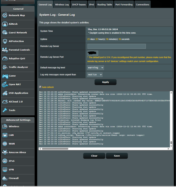

Here's a screen shot of the router's system log:
Here's a screenshot of the log captured on a remote log server:
Note that the log entries are at a "warning" log level.
The router is set to only log entries more urgent than "notice". Since the log entries for stats updates are "tagged" (sorry for the term) with a level of "warning" they appear in the log. That is what prompted my suggestion that the log level be changed to "notice" or "info".
Maybe this behavior is somehow related to the use of a remote log server. I'll try turning that off and seeing if anything changes.
Here's a screenshot of the router log after turning off the remote log server at 07:56:14. The stats update messages still appear.

I did some more digging into the script. The logger command in the Print_Output() function doesn't use the third parameter that specifies the log level. The logger command must default the log level to "warning", though I couldn't find any documentation that corroborates that assumption. I modified the script to set the log level based on the third parameter. If there isn't a third parameter, the log level is set to "notice".
Here's a screenshot from the log server after script modification:
A third parameter of $PASS now translates to "info". Ignore the two lines that say "notice". They are from when I was debugging the script change.
When the router is set to "Log only messages more urgent than: notice", the "info" lines do not appear.

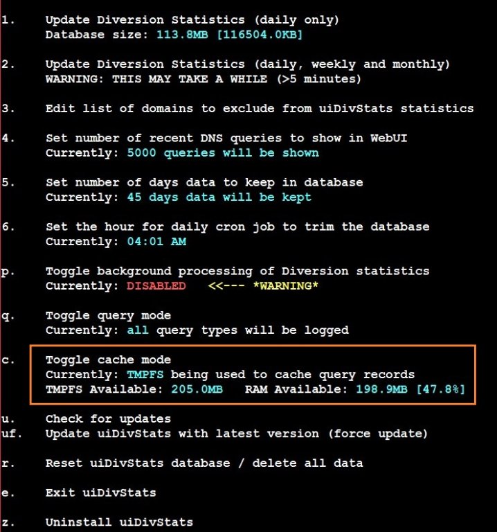

3) Added the "TMPFS free space" information to the "Cache Mode" option.
This allows users to see if/when TMPFS free space is getting too low to support database operations when the "Cache Mode" option is set to Enabled.

1) Modified the recently added "TMPFS free space" information associated with the "Cache Mode" option to include the current "RAM Available" (as provided by /proc/meminfo).
This allows users to see both TMPFS and RAM available space and check if the memory is becoming too low to support database operations when the Cache Mode is set to Enabled.
Thanks to @ColinTaylor for pointing out that the TMPFS info from df cmd does not really provide meaningful information WRT the storage space available, and one has to look at the actual RAM info to have a better idea of memory availability for storage.

Tried installing 4.0.7 today with some hiccups.
Intended Victim is RT-AX68U with Merlin 388.8.4, Entware, latest amtm and Diversion, handful of add-ons, etc. etc.
Install seems to go perfectly well but then menu shows something is not correct.
  1. During install it says its setting up user8.asp but then menu declares "WebUI page not found".
  2. Instead of showing database size it shows a truncated version of adminusername, with the letter "B" at the end.
No applicable system log messages that I can see.
Step 1: Attempts at force reinstall, force updates etc. did nothing.
Step 2: Tried reinstall then immediate reboot.
After reboot:
  1. CLI menu now shows "user7" as the UI page
  2. Database size still shows partialadminusername+"B"
  3. user7 works but shows a proper database size
Seems like a message about 'reboot required to load UI page' might at least be useful, but then there's still a little bug with the DB size in the CLI.
Screenshots below.
