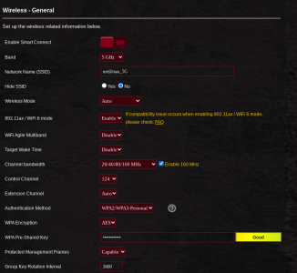

I confirm problems on AX-GT 6000 after updating to 3004.388.7_rog Randomly dropping clients on 5Ghz. After the scheduled restart on Monday, all devices cannot log in to 5Ghz. Only a complete power outage helped. The router is fully reset to factory defaults. I thought this was the cause, but the symptoms did not go away. That's why I'm here, reading if anyone else had problems.
What is your WiFi 5Ghz setup?
Will these screenshots be enough?
Yes, I know that channel 124 is DFS.

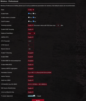

If clients Drop at 12h connection, it is WPA3 fault (device implementation of it...).

Get off the DFS channel
Do not permit 160 wide channels
Turn off roaming assistant. It's purpose is to drop connections
Disable Universal Beam Forming - It can lead to clients that hear the AP yet can't answer
The above items are common causes of problems problems. I don't recommend them
APSD is sometimes an issue
Try OFSMA only
The @ in your SSID is questionable. Some clients may have issues
Correct the bolder items, at least to debug. Then the others if you are still having issues. Once you are stable you can experiment with each of them one at a time and wait at least a week after enabling each item individually.
Good luck,
Morris

Thank you, Morris.
I once set these parameters. More for testing than there was a reason.
Of course I will check your recommendations. Maybe something has changed in the area.
I use DFS because they are the only channels on which I can get full bandwidth. There are many 5Ghz points in the area and the lower channels are very noisy.
The @ in ssid, I've been using it since wifi appeared. Only cheap routers have a problem with setting the ssid with @. However, in the name of science, I will also check this parameter
Zero changes to Wifi or drivers in 3004.388.7. Your issue lies elsewhere.
