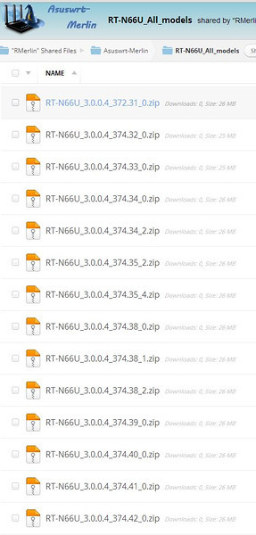

Looks like there's a .42 for the N66U to me...........or maybe I'm just all messed up and flashed .42 to my Cisco router! ;)

Have a look into the download folder: There is no .42 version for the N66U! :eek:
Or you sould read the first posting of this thread. :confused:
This would answer your question before posting it... :rolleyes:

There is! Or I am running a "ghost" version on my router more than one week .... :eek:

I am really liking the 374.42.0 on my RT-N66U
I have not needed to move my RT-AC68U from 374.42.0
Howdy Joe,
374.42.0 for the RT-N66U latest, just like your signature.
374.42.2 for the RT-AC68U latest
You should really read the post, and understand what the correct answer is.
