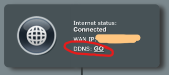

Dirty upgrade ax86u from 386.5. From main screen disappeared status of DDNS. With 386.5 it displays my ddns domain, but now it just word GO with link to my ddns provider.
system log contains records
Jun 24 19:55:49 start_ddns: IP address, server and hostname have not changed since the last update.

Do you use DNS-o-Matic?
If so, this was discussed in the beta thread and is apparently the expected behaviour...

It's expected behaviour with DNS-O-Matic. DNS-O-Matic can update multiple host names at once (by using all.dnsomatic.com as the host name). This used to result in "all.dnsomatic.com" being shown on the network map page. "all.dnsomatic.com" is an invalid host for reaching your router and probably the main reason it's not shown. "all.dnsomatic.com" also used to get transcribed into OpenVPN config files as the host name meaning that these had to be manually corrected to your chosen correct host (new behaviour inserts the current IP which also needs edited to a host name!!). The "new" behaviour (which is ONLY for DNS-O-Matic - using any other DDNS service on the DDNS page will show the host name on the network map page) shows "GO", which is a clickable link to the DNS-O-Matic login page where you can manage your host updates.
