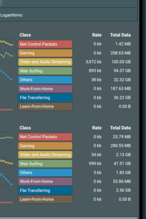

Hey everyone! This is my first post. I'm sorry if it's not on the right thread or correctly tagged. As you can see, I'm a newbie around here so I hope this is not like a dumb question.
I got my first Asus Router, an AX86u Pro, 2 months ago and I've been playing around with the configs since. My focus was to have a better experience when gaming, considering I'm trying to move from casual to a more professional perspective. I play mostly eFootball, on a PS5.
My connection is 750 D/ 150 U in Brazil, what I believe to be a Docsis system, now bridged.
Sometimes the connection feels great and sometimes it's not. With Adaptive Qos it works good, but it won't classified the ps5 traffic as gaming. I now that because when I went to classification while gaming, it would appear like this.
Then I tried to use FlexQos, with all the propper config in this case, with IP table sending all ps5 traffic to Gaming, only excluding port80. But the same happens, only, the traffic goes straight to others.
Anytime a start a game, the others bar will go up and stay there, using like 60k bits and won't go down until the end of the game.
But the weird thing is it won't show in the tracked connections. If I go there and filter others, I'll only see my other IPs.
I event tested sending everything untracked to gaming. And this way, it would send this mysterious traffic to some other categories.
Any chance you guys know what could be happening?

If you’re happy to keep using 180 down/50 up for bandwidth (as seen in your debug output), you can enable “Flow Cache Control” to Auto in FlexQoS. See if that helps. It will make the graphs match the connection list. Otherwise, iptables rules have no effect on the AX86U Pro.
You may also want to remove all devices from the Gaming Gear Accelerator feature.

Attached is my Gaming setup, Net control packets don't require much bandwidth so you can leave at top:
Also, recommend moving Learn-from-Home to the bottom
Post in thread 'FlexQoS 1.2.5 - Flexible QoS Enhancement Script for Adaptive QoS' https://www.snbforums.com/threads/f...ent-script-for-adaptive-qos.73097/post-718537
Maaaan, you know your baby! lol
Thanks so much for the help. It's working properly now. Looks like leaving the Flow Cache accelerator to off won't turn it off. I checked on the Tools section. Nut leaving it to auto, will turn it off and make It work nice and smooth.
