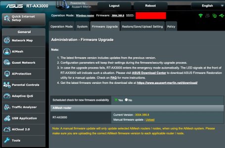

Did a dirty upgrade on my RT AX3000 to 3004.388.8 from the previous version and while everything works, just noticed that under the Administration -> Firmware Upgrade tab the option to do a manual check for new firmware is no longer present (screenshot attached).
The option for "scheduled check for new firmware" still exists, but the option to check it manually (as in the previous version) is no longer present. Could not find any reference to this in the changelog.
The only scripts I run on this router are Diversion, Dual-WAN failover and router date keeper.
I have tried the usual procedure of reboot, flushing the browser caches, trying from a different PC without any change. Since everything is working, did not try a hard / full reset.
With me it's there as always. Perhaps you'd better do a full router reset. Better still wait a few days, cause i believe 388.8_1 is coming up.
Maybe specific to your router model or your configuration (or maybe even web browser configuration). As a data point, the "Check Update" button is present in 3004.388.8 on a RT-AX86U Pro configured for router mode.
Just checked my RT-AX3000 and the button is missing on mine as well. Not a deal breaker as I never used it. It may be fixed in the next release as another user mentioned. Other than that, 388.8 is working great!
Any Javascript error when you open the browser console then reload the page?
Also go to the Tools -> Sysinfo page, and paste the content of the Features section.
