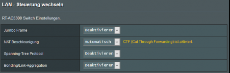

Is STP good for gaming performance or should i rather disable it?
